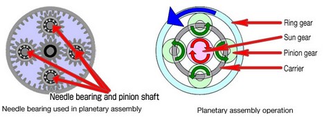

NSK Ltd. (Headquarters: Tokyo, Japan; President and CEO: Norio Otsuka) announced that it has developed a highly durable needle bearing for use in the planetary assemblies* of automatic transmissions (AT), hybrid electric vehicle (HEV) transmissions and belt continuously variable transmissions (B-CVT). This new bearing has an even longer life, and makes it possible for transmission manufacturers to make smaller, lighter transmissions. It can also be manufactured using existing production equipment, which will enable production in factories outside of Japan. NSK is targeting 1.2 billion yen in annual sales for this product in 2015.
*Planetary assembly: A gear shifting mechanism used in ATs that adjusts output speed and torque by utilizing a combination of rotation and revolution movements of multiple gears.
