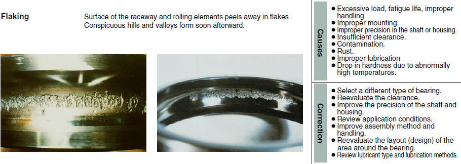

The accurate diagnosis of a bearing failure is imperative to prevent repeated failures and their additional expenses. While performing failure analysis is commonly left to outside vendors, the actual collecting of information can make a great difference in correctly diagnosing a bearing failure.
