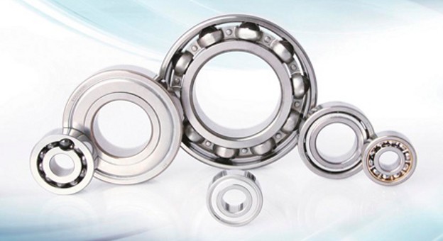

Often overlooked, Spectech have key access to specific aerospace bearing manufacturers and can make the link from industrial to aerospace equivalents for metric and inch sized deep groove and angular contact ball bearings which virtually mirror their industrial counterparts dimensionally. For many years Spectech have offered this product range – industrial sizes with aerospace standards.
Their similarity with their industrial cousins ends with the nominal dimensions. From there on in the following areas can all be potentially specified:
  • Precision class
  • Radial, axial runouts
  • Ring track concentricity
  • Track finish/super finish
  • Start up and running torques
  • Lubricant options on oils and greases
  • Specialised internal radial clearances
  • Various cage and seal designs
  • Specialist material options on rings, cages, rolling elements and seals
Above all else these products are batch traceable. What’s more small minimum order quantities can be placed for as few as 10pcs on certain ranges and types. To find out more then contact Spectech for a better bearing experience
